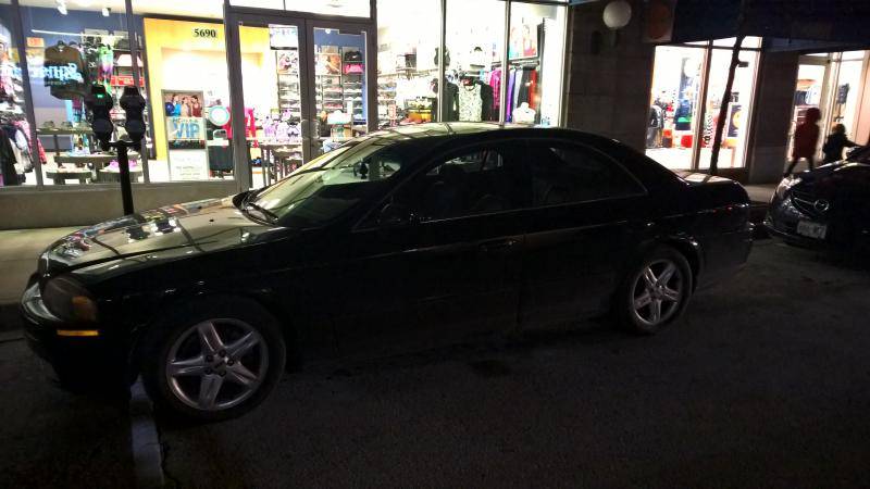

I've been wanting another LS for quite a while now but because of poor life choices on my part that hadn't been happening. Well, now I am a bit smarter and have my sheesh a bit more together. It sure doesn't hurt to find a great deal either! Two nights ago I was doing a random CL search for LS's and one popped up in Milwaukee (an hour away) for only $500! They said it had a hydraulic leak and would overheat. I contacted the person right away and ended up meeting the girl and her boyfriend the last night. I offered her $350 and she was just happy to be rid of it since she had already gotten a new car. Overall the car is in pretty damn good shape with 180k on the clock.
Not the best pic but there will be more later.
