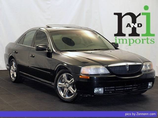

this it it
Looks like your headlight has a leak. Take it off the car, use a hair dryer to dry it out, then put a bead of silicone around the seal between the black housing and clear lens. :D
