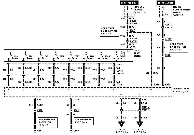

Can anyone tell me which wires on the seat tracks make the seat go forward and backward?
Please help!!!

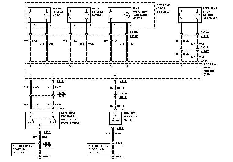

Y/W and R/W.
It's controlled by the module. If the seat won't move there is a problem with the module, the wiring, a motor, or a motion sensor. Look for broken wires coming out of the floor to the seat. The module may not be getting commands from the Memory switch.
One motor move the seat front & back. The polarity changes and both wires are grounded to make the motor stop fast.
What are you trying to do/fix?
No, Iam not trying to fix. I went and got some seats out of the junkyard. I needed to move the seat tracks forward to remove the rear inside nut. I was trying to jump the wires at the switch. No success. I was able to get the seat a different way. So all is good now.
