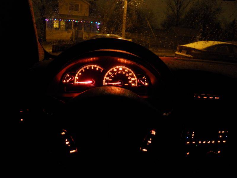

I considered swapping (or at least trying to swap) needles and the gauge face (it's just a thin plastic sheet), but I got tired of my gauges not being orange and just went ahead with the LED swap. Plus, there aren't nearly as many Gen 2s in my local junkyards as there are Gen 1s. I don't think you can swap entire clusters.
Quick toot of my own horn... I had to add individual red LEDs for the needles. Otherwise, they don't light up at all due to any non-red or non-white LEDs emitting the wrong wavelengths
The tapering brightness isn't as noticeable in the picture as real life, but it's there. The tach is definitely brighter because one of it's LEDs is placed much closer to the center of rotation than the others.
Dude that actually looks really really good! Much better than the icky stock green...
Wow LSFrank, that looks awesome! What kind of leds did you use?
Orange- standard 168 5x5050SMD LED replacements, though I had to buy ambers and replace each individual LED. Orange is nonexistant. All orange results are actually "orange/amber" which are just yellow

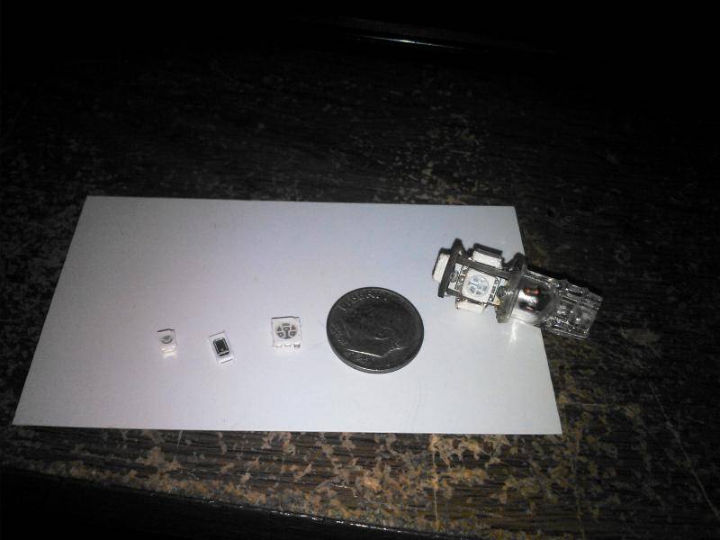

Needles: I cut a slot into the clear plastic backing and placed individual red 5050SMD LEDs that I prewired with 30ga wire (I'd go with 26ga at the smallest now that I've learned). This way, the LEDs sit flush with the clear plastic and don't interfere with the prongs sticking out from the needles' galvo motors. I'd go with a single-chip SMD LED, probably a 5630 (brightest) or 3528(medium). 5050s(bright) are 3 LEDs in one, requiring funky self-series wiring for compactness, and are brighter than necessary.
3528/plcc2, 5630/5635, 5050/plcc6, dime, 5x5050 for 168 replacement
