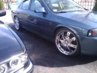

Hey Lito, go to my photo gallery and you can see my LS lowered. At the time of the photos, I had 225/45/18 in the front, I now have 235/45/18 (have 245/45/18 rear). It fills in the wheel well better and also a little more gronf clearence.

Yes those are 18's.
