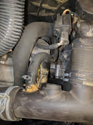

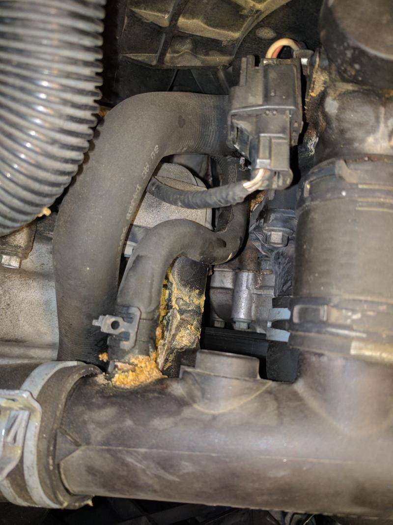

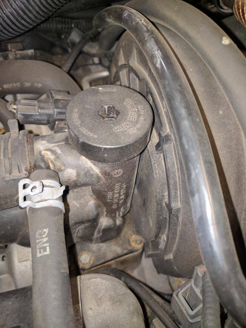

2002 3.9L sport. Had the dreaded "no heat" problem, and today on the way home from work noticed the temp gauge pass briefly above the halfway mark. Found this:
So clearly it's time to bite the bullet and replace all the plastic cooling parts. I already have the Jag aluminum tstat housing, so fortunately I don't have to buy that. But for everything else, here's the shopping list I've put together. If there's anything I've missed, or if anything is wrong (or you know where I can get a better price), please let me know.
