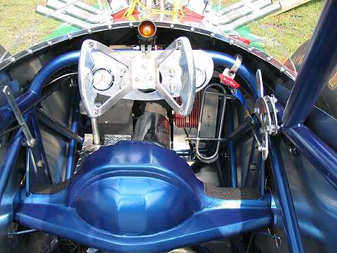

On a sling shot dragster you want to make sure the rear is setup dead on.
Because your nuts sit on the third member :eek:
