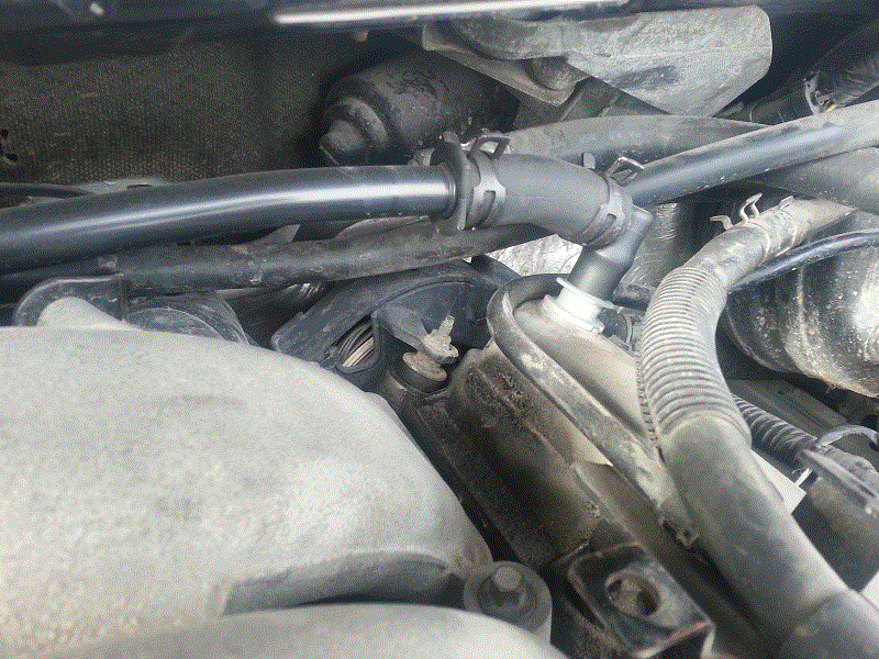

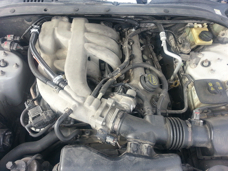

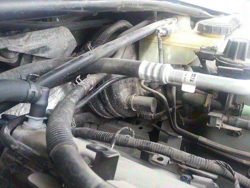

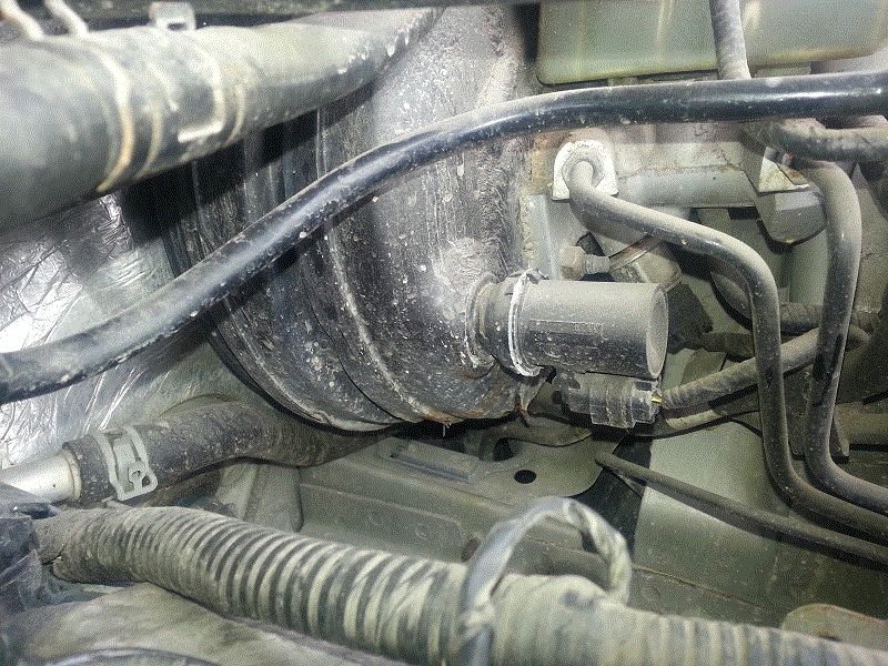

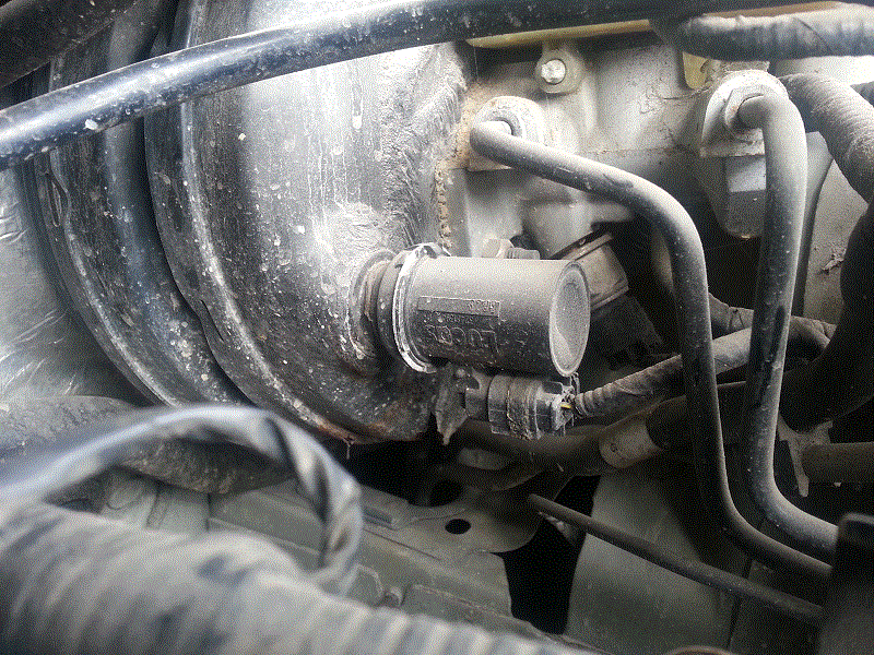

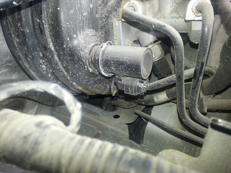

I think you still have a vacuum leak or a bad check valve to the vacuum booster. It could be the booster itself or the plumbing going to it. After engine shutdown, you should still have at least one good full power-assist press of the brakes left. Can you take a picture of the vacuum plumbing to the booster, including the in-line check valve?
Taking pics this morning...I know where the vacuum booster is , but not sure where the check valve is located or what it looks like. Is it in the same area?
It's the plastic thing in the middle of hose 9C490.
I think you may have led me directly to the issue...Took the pics and discovered that I have 2 rot holes in the booster itself...took a few photos of different hoses and such.
Just have to downsize the pics and will post them
After a closer look...the coating was peeling but no holes. I am going to replace the hoses and check valve before replacing the booster. Is there not an easy way to check if I have low vacuum before buying and installing a bunch of parts, just in case they are not the issue, but only a symptom of something. I have checked the web and quite a few LS owners have had this same issue, but no one has posted what the final solution was.
