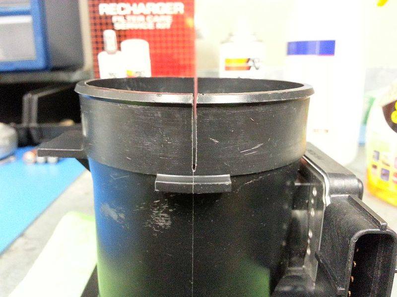

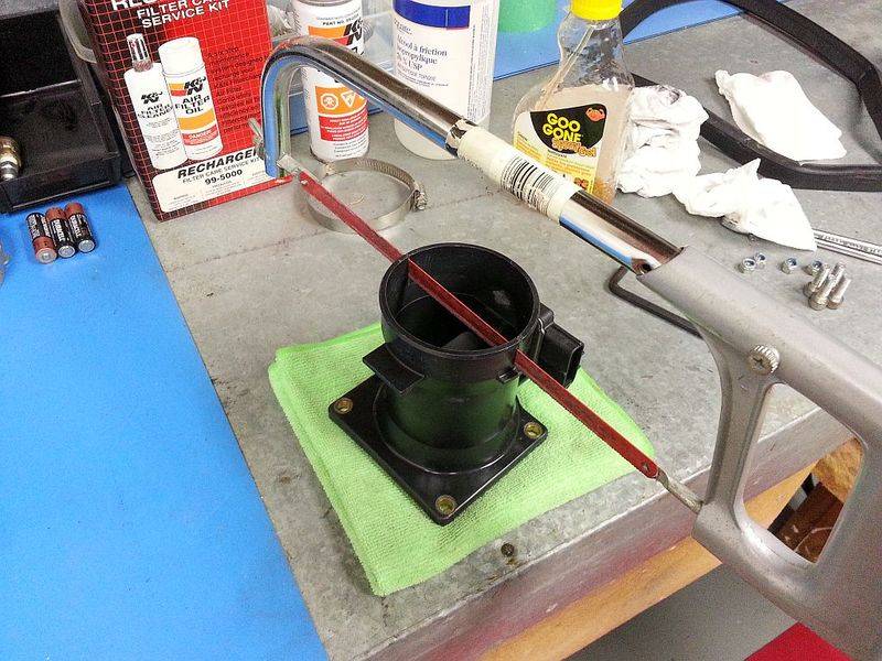

BigRig, I see you cut hard plastic, then on the next pic it shows hard plastic to metal. I understand the reasoning behind the cutting, but is there a rubber gasket between the MAF and the metal tube? If not I see that as an area that will leak air, all the way around between the metal tube and hard plastic. That was really designed to have a rubber tube pulled over it, not have a tube stuck inside of it. If it becomes a problem there are companies that sell silicone MAF couplers, just have to find one with the right size.
