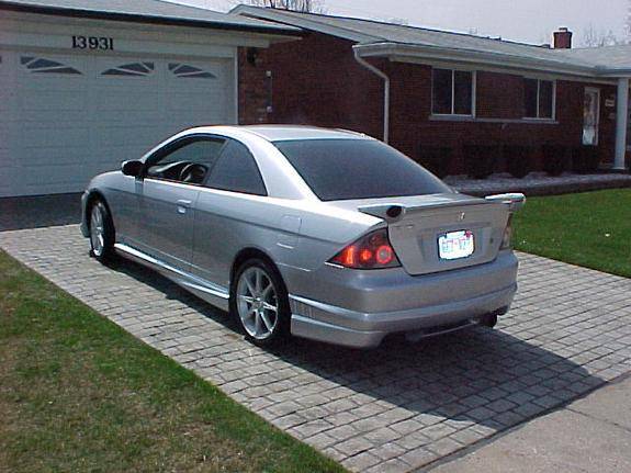

at least my wing on my civic isnt horrible.. :N
