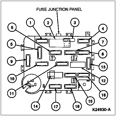

I need some one to help me out. I am looking for the fuse schematics for a 96 Mark VIII can anyone help me out???
Cavity Number Fuse Amp Rating Fuse Color Circuit Protected
1 30 Amp ATC Lt Green Circuit 181 (BR/O) Blower Motor
2 Not Used — Not Used
3 30 Amp ATC Lt Green Circuit 65 (DG) Wiper/Washer
4 25 Amp ATC Natural Circuit 195 (T/W) Parking Lamps, Relay, Headlamp Switch
5 10 Amp ATC Red Circuit 298 (P/O) Rear Defrost, EATC, Brake Shift Interlock, Traction Control Switch, Remote Keyless Entry Module, Anti-Theft Control Module
6 15 Amp ATC Lt Blue Circuit 931 (O) Courtesy Lamps, Power Mirrors, Dome Switch, Electronic Door Lock Control, Memory Seats, Auto Lamp Switch, Anti-Theft Control Module, Remote Keyless Entry Module, Memory Mirrors
7 10 Amp ATC Red Circuit 32 (R/LB) Power Antenna, Anti-Theft Relay, Memory Seats, Memory Mirrors
8 20 Amp ATC Yellow Circuit 40 (LB/W) Cigar Lighter
9 10 Amp ATC Red Circuit 640 (R/Y) Transmission Control Switch, Autolamp Sensor, Electrochromic Mirrors
10 15 Amp ATC Lt Blue Circuit 294 (W/LB) Suspension/Steering Module, Electronic Flasher, Steering Wheel Position Sensor, Daytime Running Lamps, Backup Lamps, Air Bag Diagnostic Monitor, Multi-Function Switch, Anti-Lock Brakes, Transmission Range (TR) Sensor
11 15 Amp ATC Lt Blue Circuit 10 (LG/R) Stop, Hazard Lamps, Brake Pressure Switch, Multi-Function Switch
12 Circuit Breaker
20 Amp — Circuit 517 (BK/W) Power Seats, Fuel Filler Door Release, Luggage Compartment Door Release, Shock Damping Control
13 10 Amp ATC Red Circuit 59 (DG/P) Heated Mirrors, Compass, Rear Window Defrost
14 Circuit Breaker
20 Amp — Circuit 170 (R/LB) Roof Sliding Panel, Power Windows, One-Touch Down Module, Right Front Power Window Switch
15 10 Amp ATC Red Circuit 16 (R/LG) Warning Lamp Bank, Instrument Cluster, Chime Module, Charge Lamp, Delayed Accessory Module
16 10 Amp ATC Red Circuit 797 (LG/P) Air Bag, Power Antenna, EATC, Warning Lamp Bank, CD Player, Radio, Message Center
17 10 Amp ATC Red Circuit 296 (W/P) Radio, Chime, Electronic Door Lock Control, Power Antenna, Anti-Theft, Compass, Message Center, Cellular Phone, Memory Seats
18 10 Amp ATC Red Circuit 14 (BR) Front Park Lamps, Chime, Power Mirror Dimmer Control, Front Side Marker Lamps, Rear Park Lamps
