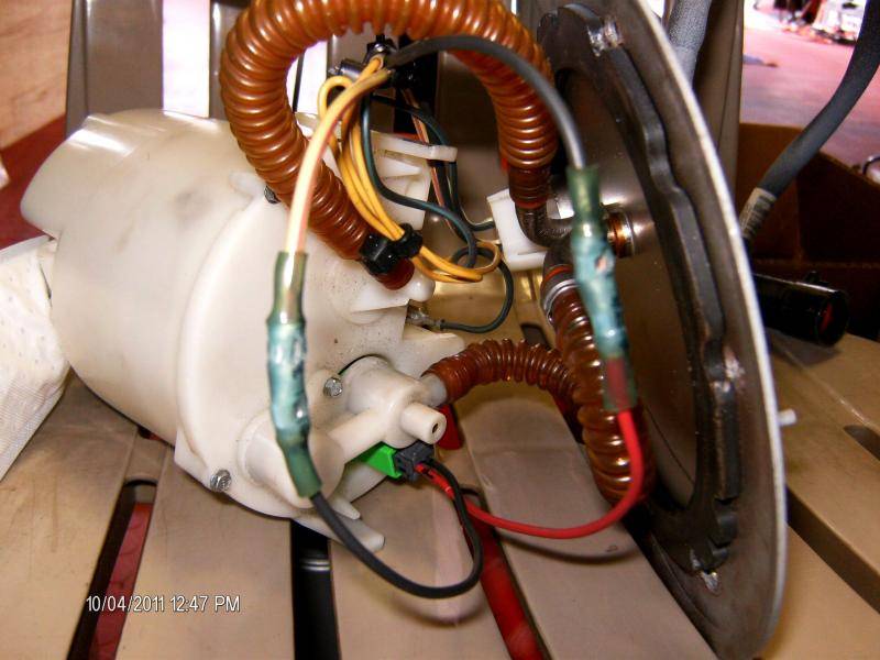

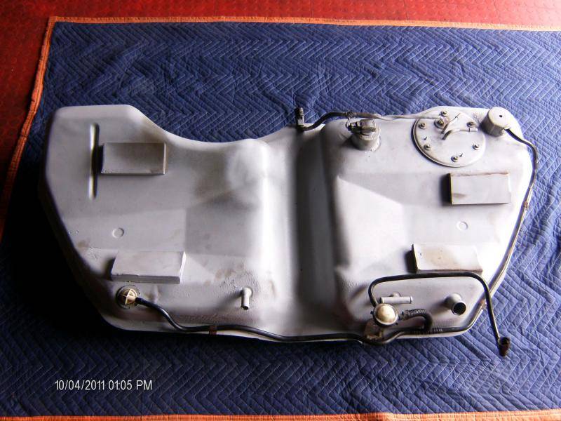

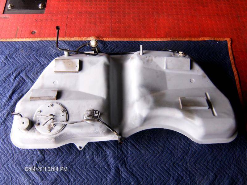

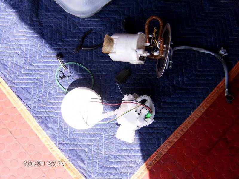

Here are a couple of pics of a '97 Gen 2 fuel tank that I recently swapped a SVT Focus fuel pump into, and then installed into a '98. The '97 and '98 tanks are identical, some of the external emissions piping is a bit different, but the tank itself is the same.
