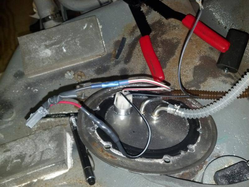

Is there anything you need to do, to put a 255LPH pump in a gen1? Iam getting a p0232. Please help.

yes it is a 96. I have never had this code until I installed a 255.
Dumb question because i don't know how much of the 96 was gen2 but i know the 255 pump will have issues in the gen2 because of the fpdm being variable voltage. Does the 96 have a fpdm?
You dont reverse polarity
Just colors look wrong
Also plenty of people have run a w/255 with no problems but some have thats why i ran a focus pump.
No i did not reverse the polarity. It was a straight plug in.
