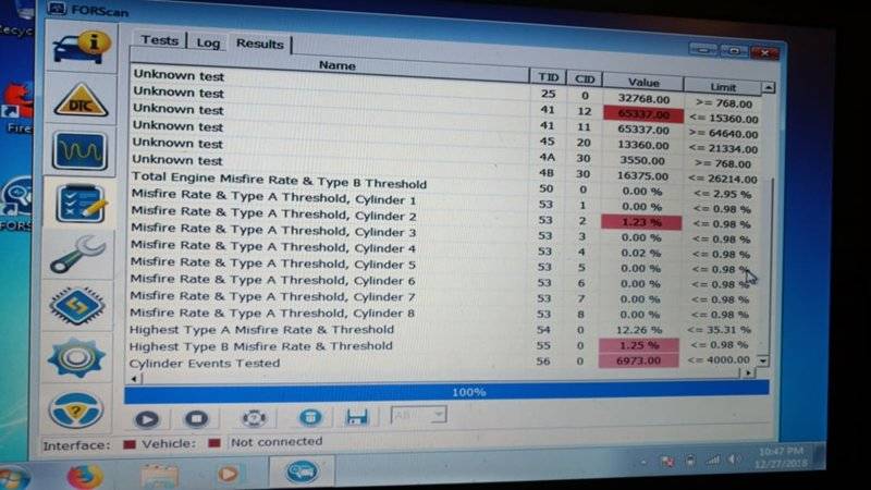

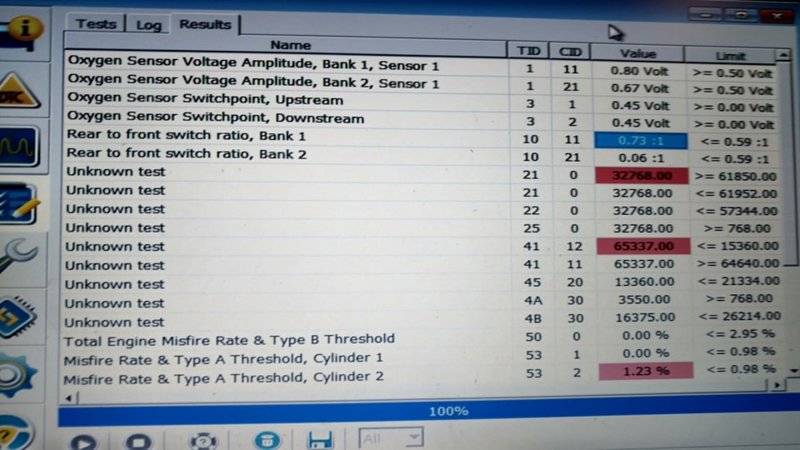

View attachment 828571132 View attachment 828571133
Edit:
Long crank came back that shop was worthless.
I know it's frustrating when you know more about the car thanks to LVC compared to the mechanic that you're paying to diagnose it...I guess I've been wondering this...When you say long crank, how many times does it crank before she fires off?
Well just a few mins ago it took 8 secs and failed, it took 4 tries to crank. And was a miserable start when it finally did.
