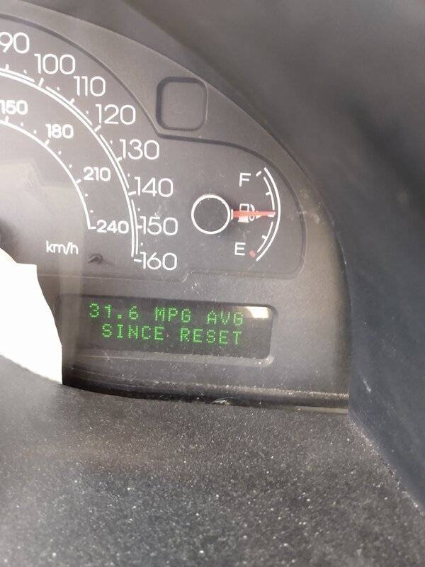

Today. Rural state route. 20 mile trip to next town. Temp 90 degrees. No wind. Flat ground. Speed... 57-58 mph (no cruise control).
Just shows what the LS is capable of... even at 257k miles.
