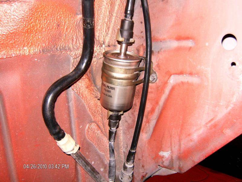

Hey everyone. So my Mark is currently sitting on a jackstand in my drive way with the wheel, and wheel house off the car. I got the clips out of the fuel lines on the top and bottom of the filter, but for some reason, the filter wont come out of the fuel lines for some reason, its stuck. I'm wondering if there's some twist/pull/squeeze combination that I need to do to get them to release, or if I just need to pull harder? It looks like a factory filter that's never been replaced, so I'm sure that isn't helping the situation at all, but if you could give me a hand, that would be much appreciated! :D
I have not done my mk8 filter in awhile so just shooting what i know. Ford uses couple ways to link fuel parts together. If yours uses the plastic "horseshoe" pull off C clips then filter is ready to be pulled off. If yours is the circular type that no clip gets removed you need the "push lock" tools to remove filter.
Once you've removed the white plastic clips, the lines should just pull off. Be careful not to twist or kink the lines.
Thanks guys, they ended up popping off, with a little extra force. Turns out it was indeed the factory installed filter with 174k miles on it!
After getting it off, I went and shook it over a glass jar, and what looked like coffee came out! I blew through it, and there was almost zero flow whatsoever, so hopefully, this and the K&N will increase my mileage slightly!
