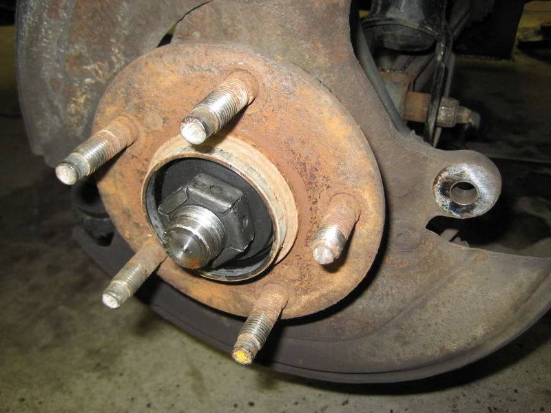

How the hell do you get this nut off!?!? I have an 18" breaker bar with a 36mm socket on it, & can't break it loose!?

Yes it would. These bearings usually carry a torque requirement of 225 to 250 ftlbs during installation. My neighbors 03 cobra had a left rear hub bearing which was undertorqued from the factory it only had 3 threads showing. We tightened the wheel the next day, and he drove around for 5 minutes. His wife couldn't touch the wheel it was so hot. Bearing made no noise whatsoever.
thats because it sounds like you overtorqued it andcrushed the bearing
The Mark VIII has a very specific bearing torque specification and has to be followed closely (Ie: only torque 'up to' the rating and do not back it off. It is a 'crush' type nut and has to be done right. Somebody that has AllData or a Mark CD can post the torque rating. I think it is higher than 250 if my mind serves me right.
Ok... I tried posting but for the past two weeks it TAKES FOEVER for a post to post after I click on "post quick reply".
Anyway. I just did mine. The torque rating is 188 to 254 lb-ft. I do mine to 210. I would never do more than 225. This is per factory shop manual.
Thats what he was getting at, it sounds like it was lose and then you over-tightened it. It should not have gotten hot at all. I can put out over 300 ft lbs with my 1/2" bar so its possible.
My specs from my 93 disc said like 251 so I put it at 250 replaced all 4 wheel bearings in the last month no noises what so ever. Cobra hubswap.... getting those rear knuckles apart was a nightmare for my friend. Oh and i got this torque wrench which is amazingly awesome. Its call the Brutus from snap on makes removal of those 36mm nuts very easy.

Install new front axle wheel hub retainer and tighten to 255-345 Nm (188-254 lb-ft).
straight off of fords tech site :)
See, thats what I posted too. 254 is the MAX. Given that most by after-market hubs I would not entirely trust to torque up to max.
