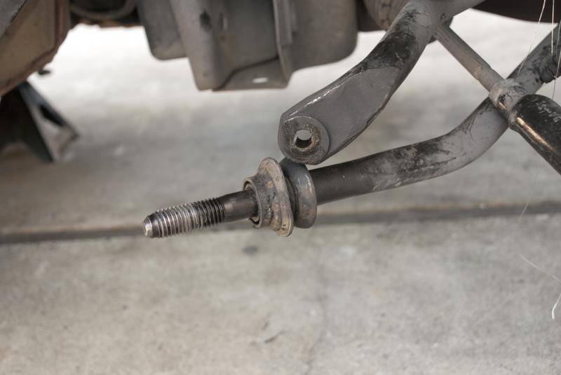

Ok, the lower bolt of the front air shock goes through the lower control arm. My problem is the bushing, do these need to be pressed in or something?
I do not have my hands on this new part, the old ones are in peices. The inner metal sleave that is in contact with the bolt came out with both bolts.
Is there also a metal outer sleave that is in contact with the lower control arm hole?
Am i really going to have to take off the lower control arm to replace these bushings? Thanks for your input

I see some LCA have the bushings allready in them. I am trying to avoid taking off the LCA. If the bushings have an outer sleave they both are at this point stuck in the LCA or they are pressed in?
I was thinking taking a hack saw blade to the outer sleave though the LCA bushing hole to create enough room free them up to beat them out, with less beating needed.
The bushings are about $30-50, I see new lower control arms are about twice the price of the bushings.
What are SRB's are they the forward and rear bushings for the lower control arm or this peice in picture?. I see many people having these new one fail from dayss to weeks if not ford oem?

Thats what I was (past tense) trying to avoid removing the lower Control arms, every things metric on this car and my metric tools are few. I don't have the right size metric impact or any sockets to fit to remove the LCA nuts and lower ball joint nut. Yes that what I thought, the srb's are what I pictured on opposite end. Everything else is good, not new, upfront except the lower air shock bushings though the lower control arm. Thanks for the Rock Auto heads up their prices are low.
Anybody know if the LCA bushings for the front air shock lower bushings can be replaced without pressing them in or removing the LCA. I may think of rigging up a C-Clamp to press them in,anybody with an tried and true way that works while the LCA are still attached to the car?
You would need a Shop press to remove and install that bushing. This would require removing the LCA. Much much easier to buy new arms. I cannot een remember anyone posting up that they have replaced it. There might be a special Ford tool to remove it on the car.
That strut rod bushing is a slight press fit. You just need to hammer it off. Spray it down and start hammering. You could burn off the rubber and then heat it up with a torch. It will probably slide off when hot enough.

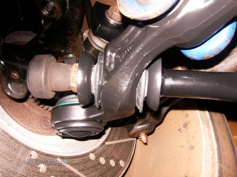

What about the missing bushing that would be on the "new T-bird" LCA Pictured as referance
Are the strut rod bushing/LCA I use here a Mark Viii or a T-bird, I am a bit unclear at this moment what is different other than watch out there is something to be aware of, I just don't know yet. Please fill me in your your solution, I am unclear because the LCA have two different places of prepressed bushings{one at frame, another at shock and last but least; the missing SRBushing for the strut rod in the above picture}:confused:

This might help you understand the strut rod bushings, they are usually not included with the LCA's.
http://forums.tccoa.com/showthread.php?t=135491
I'd recommend using only the OEM parts.
The Thunderbird and Mark VIII front suspensions are virtually identical, except for the air shocks. No issues using Thunderbird LCA's on a Mark VIII.
