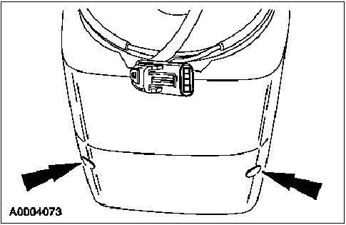

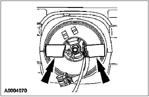

µ 6. Apply two strips of masking tape across the clockspring to prevent accidental rotation when the clockspring is removed.

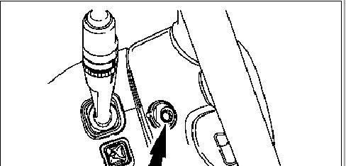

µ 7. Remove the two screws and the lower steering column shroud.

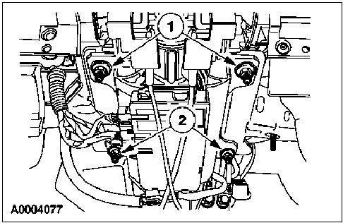

µ 10. Lower the steering column.
1 Remove the two steering column retaining nuts.
2 Loosen the two steering column retaining nuts enough to pivot the steering column and remove the instrument cluster finish panel.

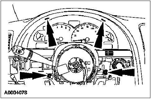

µ 14. Remove the upper steering column shroud.
Vehicles with hands free microphone

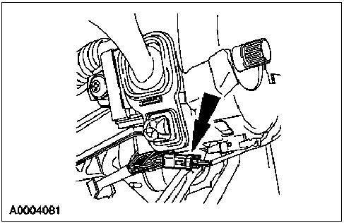

µ 15. Disconnect the microphone electrical connector.
All vehicles

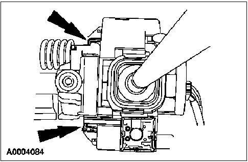

µ 16. Disconnect the steering column position sensor electrical connector.

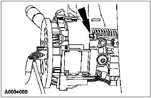

µ 17. Separate the clockspring electrical connector assembly from the steering column.
1 Disconnect the remaining clockspring electrical connectors.
2 Release the four clockspring connector assembly retaining clips (two shown).
3 Separate the clockspring electrical connector assembly from the steering column.
µ 18. Releasing the three clips, remove the clockspring with the multi-function switch.

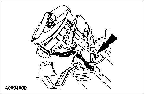

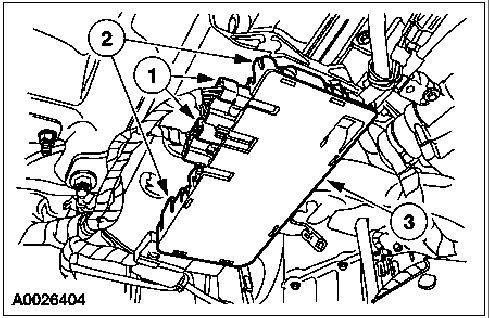

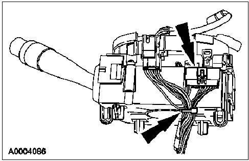

µ 19. Cut the tie strap. Disconnect the electrical connector.
µ 20. Releasing the tabs, separate the clockspring from the multi-function switch.
