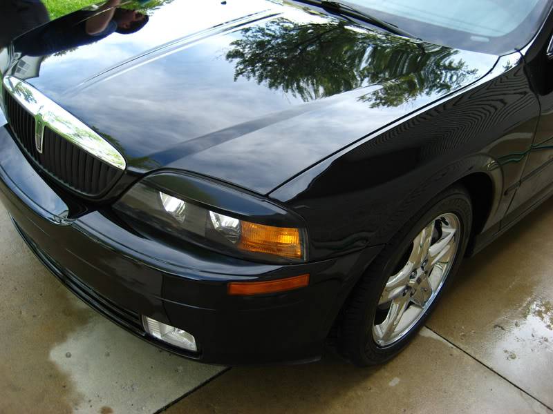

Are you sure there aren't any Hairline cracks or anything? Because after I painted my eyelids on over some hairlines they stopped fogging, not only did the paint seal it (after 3 or 4 coats) the black collects light and heats up the housing on the outside actually helping to remove moisture.
