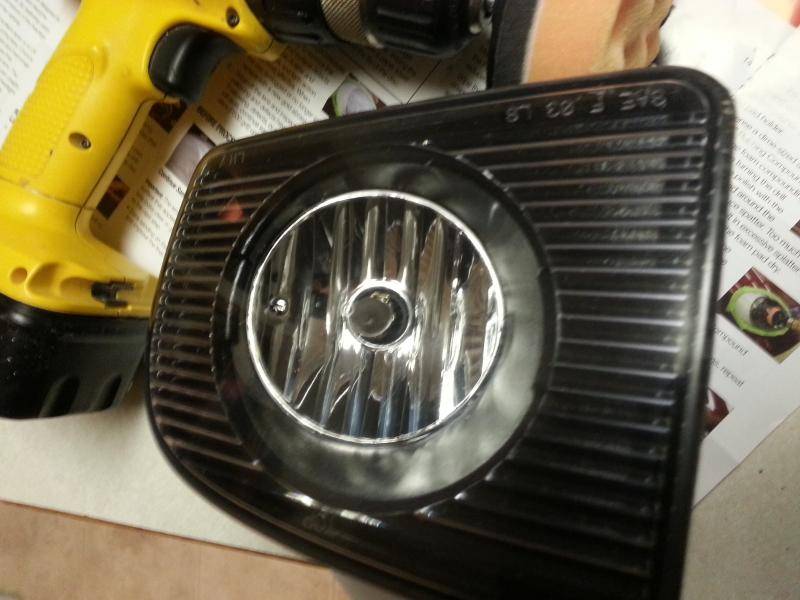

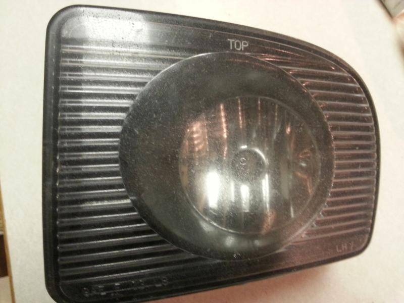

I removed my lights from the car by unscrewing the three 11mm nuts and then removing light. next i unplugged the wires that connect it to the car.
I used a $21 3m kit purchased from autozone.
before
after

first time i've ever done it so it took me about 15 minutes to do each light.
