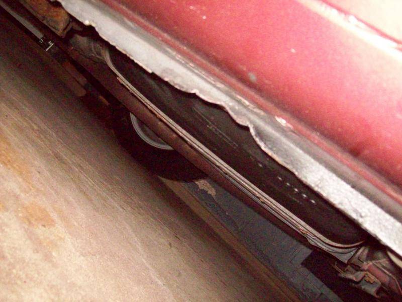

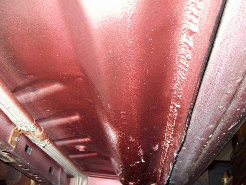

Here's the repair to the floor pan and pinch weld. They missed a little PW about in the center of the car. Easy fix. They painted the pan but undercoated the PW.

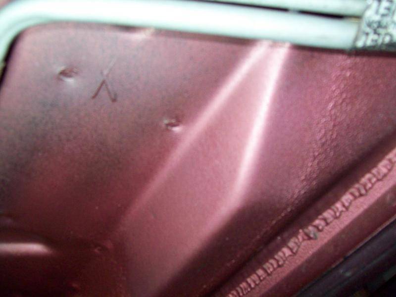

They didn't bother taping off the fuel lines?
They should've sprayed them fully. The lines are uncoated aluminum on 1st gens, and corrode badly.
