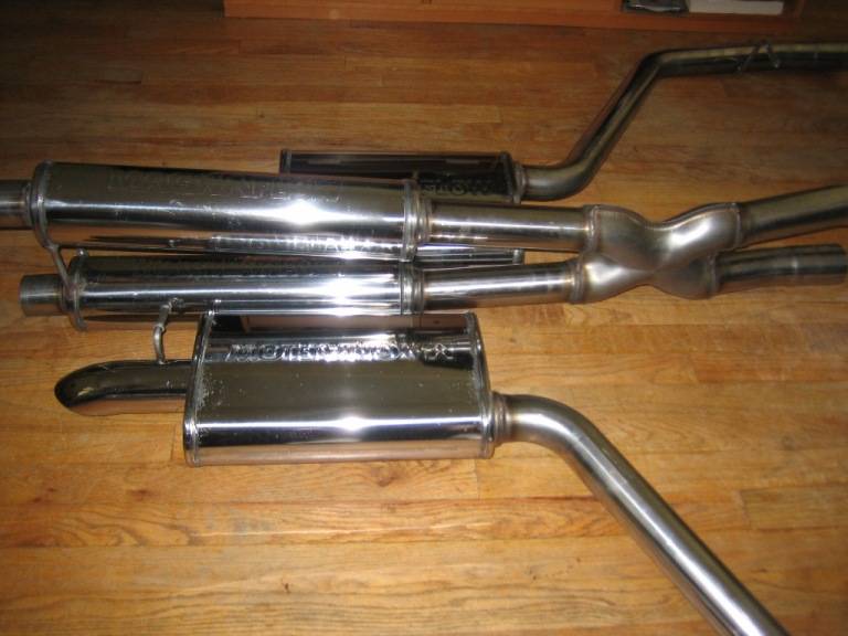

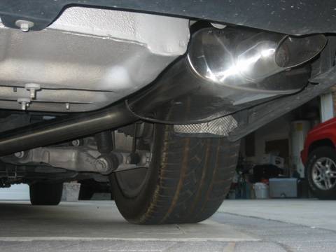

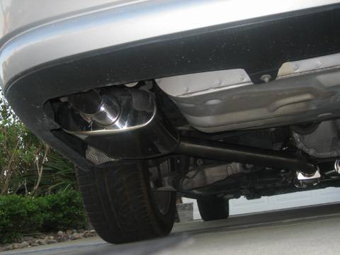

got it install yesterday, i think i am gonna do the tips soon, i just wanted it on asap. sounds really nice would recommend it to anyone.
heres some pics...
where did you get it? is it magnaflow? is there anyway you can post a sound clip of it?
www.hottexhaust.com, with chr0mes discount. yes it is the magnaflow system, i will try to get a sound clip. Its kind of hard to really hear it open up unless your driving, due to the rev limiter at 3,000 rpm.

I made tip holes the easy way...I bought some lame tips from autozone and stuck them on the exhaust, evenly of course, and drove it so the tips would melt the surrounding part of the tips. I pushed the mleted peices off while they were still a little hot and it left me with a real even curve. I took a razor to slice the plastic off the tips. I did this about 4 times and now have a nice smooth half circle. Anyone like pics?

Magnaflow. Car is in the shop right now, the windows are being fixed, will get on this ASAP. I trimmed mine up a bit so it wouldt vibrate againts the bumper. It's only temporary though, until I get a body kit.

Where the exaust cross each other, is there a reason why it's not a straight through exaust, that way avoiding the cross???
u mean magnaflows tru-x pipes?
Smooth Transitions
Stamped Y-Pipe and Tru-X Pipe transitions are great for single/dual, dual/dual and balance tube applications. MagnaFlow's stainless steel Tru-X crossover pipe represents a significant leap forward in technology over traditional H-pipes. The more gentle radius allows for better exhaust gas scavenging, noise cancellation and better balance between cylinder banks. The result is a significant increase in power and torque but a reduction in db sound levels... the best of both worlds.
MagnaFlow offers Tru-X crossovers as part of most of our cat-back and crossmember-back dual exhaust systems. They're also sold individually in 2.25", 2.5", and 3" configurations. The center cores are either 2.5" or 3", depending upon the part number you select, so check the application chart carefully. The length of all of our Tru-X crossover sections is 12 inches overall, making it compact enough to work in most applications
