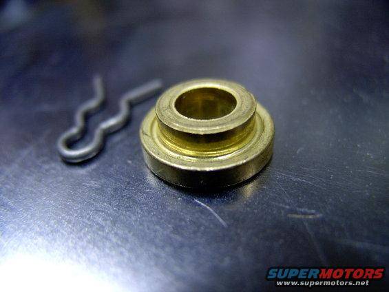

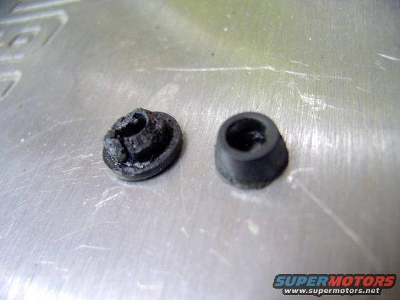

Think you'd best have a REAL GOOD look at your TV cable bushing;
Yours;
What you wants;
Before you blows up that AOD !
Sixlitre
