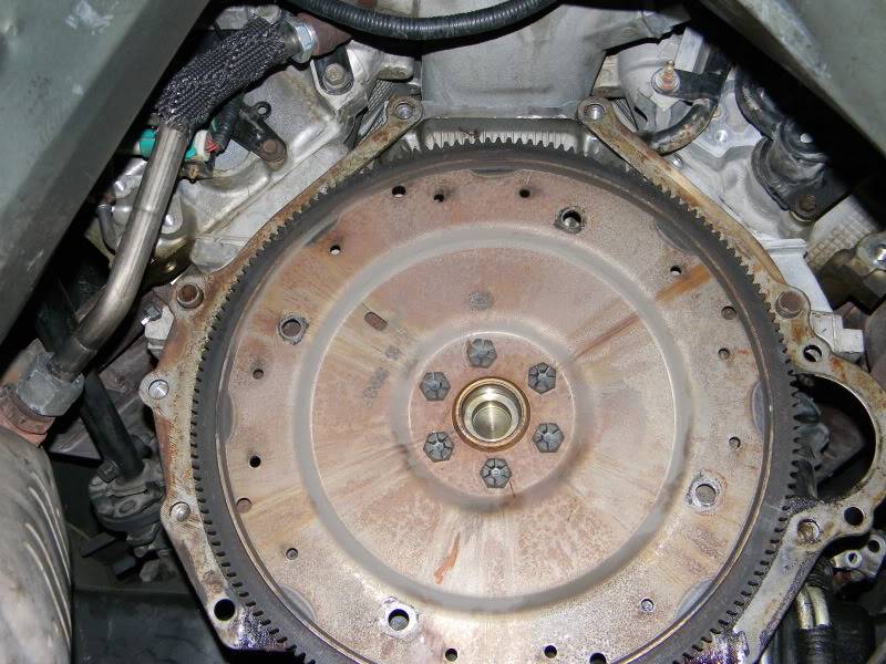

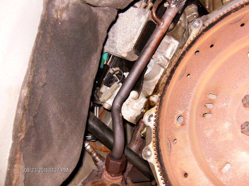

This nut is on tight as hell. Any ideas on breaking this loose?
After all the guys say pb blaster just heat it up. I don't know how many of you guys can do exh work without torch set!! Well I live in Northeast too.
PB Blaster soak, and if that don't work, heat it first with a torch.
You might try smacking the wrench with a hammer - the shock may help start it loose (I've done it).
OK, are you saying that you need two wrenches to get the tube off? I don't want to strip anything.
When i mention heat I mean oxy/acetylene not a propane torch. If you heat red everything comes off.
