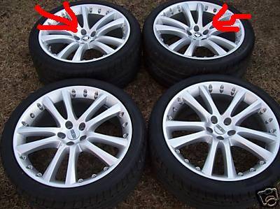

Ebay find!! 20 Jag rims on an LS

I just know the rear offset on the jag staggered wheels is between 20-25mm. The front offset is 42mm.
Doesn't look like that in the pictures. Looks like a pretty high offset. If they fit the S-Type they should fit the LS.
The fronts look high but those rears look like they set back further than what the tips of the spokes sit on the rim of the wheel.
I don't think that picture was his. Our LS's need 4 of the front wheels from the jag to work properly.
You're right it doesn't look like the full staggered set in the picture. And the 42 jag offset should fit our cars perfectly.
If they were not the staggered set, I would think they would fit.
Of course, I'm not the definitive expert on offset/fitment so I could very well be wrong.
I got the pic I posted from the ebay auction. Those look staggard to me man.
I contacted the seller. He tried them on his wifes LS and they rubbed, but he ended up lifting the rear about 1" and they fit .
