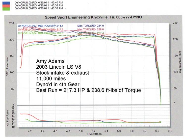

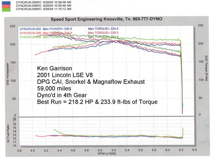

I ran the KKM induction kit along with the stainless steel intake tube. We estimated the increase in HP at around 15 HP but since we did not dyno the car without the Magnaflow exhaust system we only estimate the increase. According to Magnaflow's website they dyno'd their exhaust system on an LS and it resulted in 11 HP and 10 lb-ft of torque gain.
We also dyno'd my 2001 LS that had the KKM, stainless steel intake tube and Magnaflow exhaust system against a stock 2003 Lincoln LS. My LS pulled 218.2 HP and 233.9 lb-ft of torque at the rear wheels. The stock 2003 LS pulled 217.3 HP and 238.6 lb-ft of torque at the rear wheels. So, by adding the KKM, stainless steel intake tube and Magnaflow exhaust system to my 2001 LS my car out performed a stock 2003 LS. This means my 2001 LS made up the 28 HP difference from an 00-02 LS vs. 03+ LS. Remember, a stock 00-02 LS rated 252 HP at the crank and a stock 03+ LS rated 280 HP at the crank.
These bolt on performance items do work and the dyno numbers tell the tale. You can view the dyno sheets below.
