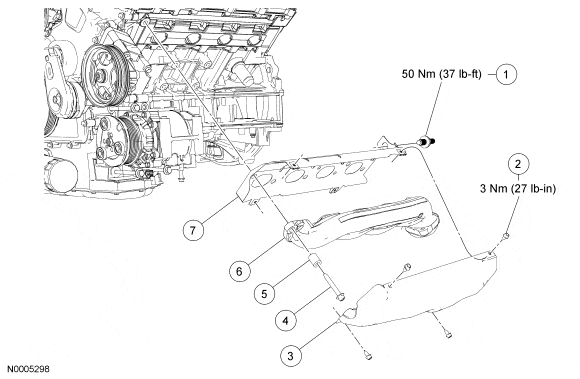

Does anyone know if the 3.9 has exhaust manifold gaskets or not? The connection between the manifolds and the catalytic convertors do not have a gasket but I can't find any information on the exhaust manifolds.
My 06 service manual shows one. I would assume all years have it.
(#7 in pic)
