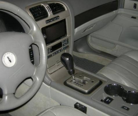

Does anyone know if the Kenwood P-NAV6019 (dvd navigation combo, DDX6019, and KNA-G510) will fit in a LS. The reason I ask is, Crutchfield, and Sounddomain.com, say it doesnt fit. But crutchfield says the pioneer avic d3 doesnt fit, but i have personally seen that head unit in an LS before. Come to think of it I cannot think of a website that says any double din in dash moniter fits in a LS. Appreciate any advice, thanks guys.
dont see why not, I have a double din D3 that supposedly wouldnt fit into the LS in my dash.
crutchfield says it doesnt fit because they dont offer the double din installation kit. Without the installation kit you cant install any double din decks. Any double DIN will fit in the LS, fordpartsonline.com + lskoncepts.com both have the installation kit needed.
