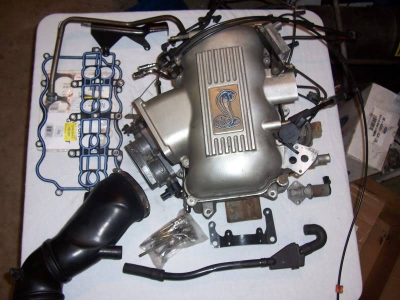

I bought a 94 thinking 4.6 DOHC powa. Swap it into my 73 F100 add some performance parts and I'm good to go. Was thinking of swapping a 96-98 Cobra intake, but my heads are different or something? Couldn't get a full explaination, so I'd thought I'd vent here and see if any of you can post up and fill me in. I didn't want to go too crazy with the rebuild/performance stuff, but thought a cobra intake swap was definately in order along with the new TB/Intake, and long tubes. Add a tune redo the gears for the 4spd auto (Was an old C-6 trans). That's pretty much it.
Any thoughts about the Cobra intake swap, different heads I have, etc. please post up.

You mean all this stuff? LOL It will fit on all year Mk8's.

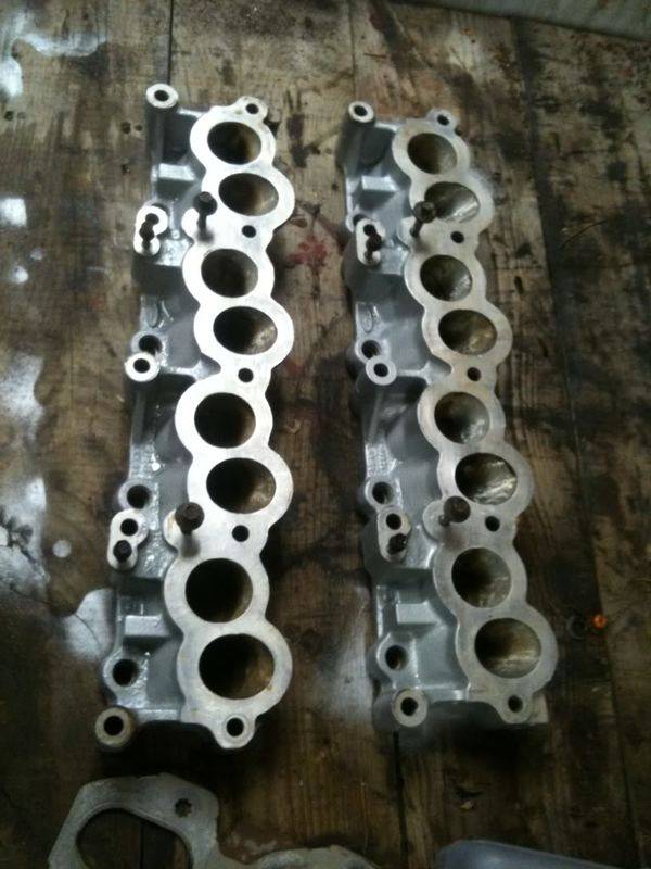

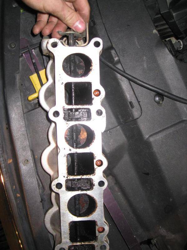

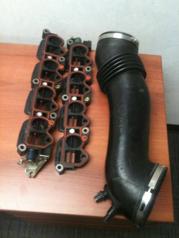

the IMRCs changed from 93-96 to 97-98 with regards to circles and squares. maybe that is what he is thinking of.
93-96 mark, both circles on the intake side.
97-98 mark, 96-98 cobra, one circle, one square on the intake side.
they both look the same on the side that bolts to the heads. one circle, one square.
