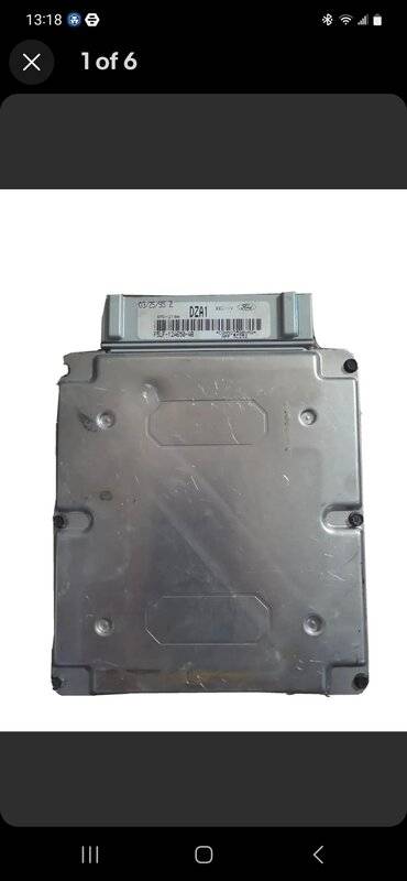

Like this dza1
The CPU or PCM is behind
-the plastic trim
-the metal bracket that holds up the OBD port
-It is situated in a plane that is in line with vehicle travel above your brake pedal.
-You will see the PCM connection harness before you see the PCM.
-The harness is held to the PCM by a screw that goes thru the harness into the terminal end of the PCM.
-The PCM is a silver metal box approximately 1.5" x 6" x 8"
-It is retained in place by a plastic lever that you pull down to unlatch the PCM.
