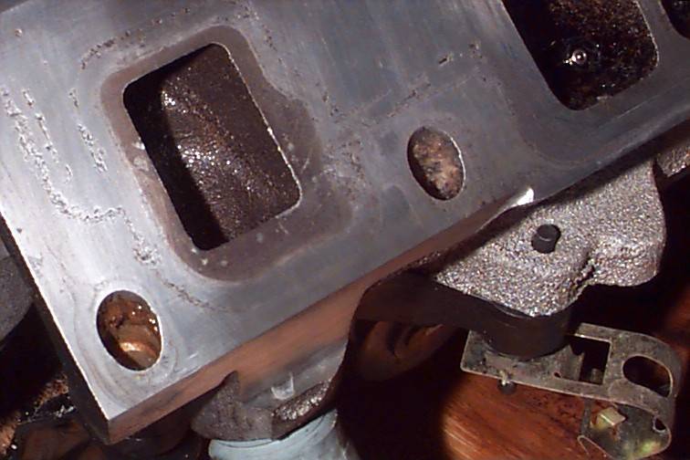

I agree, someone put the orange stuff in if you have gelling antifreeze in there. That stuff is corrosive enough to etch the heads too. Here's a pic of a Chevy Vortec head that had a weeping intake gasket allowing Deathcool to seep around it.
