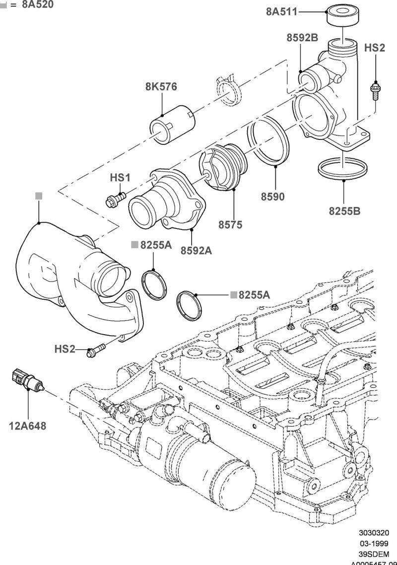

So, the leak is coming from the plastic union where the thermostat resides. My question is, is there another gasket there besides the thermostat gasket (o ring)? I ask because as I was taking the 3 screws off there was a very thin rubber like gasket there but I think it may have been put there by someone other than dealer. My second question is if I should also add that gasket which seems to be that "make your own gasket" type thing they sell at local auto part stores? It just seems that if only the o ring from the thermostat housing is there it would leak. Thoughts?
I only see the one o-ring like gasket, but I don't have a gen I to look at.
The only gasket between the cooling tower(8952b) and thermostat housing (8592a) is the rubber gasket (8590) that comes with the thermostat. Theres no need to add anything else.
You would be wise to replace the cooling tower and cap with the Jaguar metal parts. They're not expensive, and they shouldn't ever fail again.
