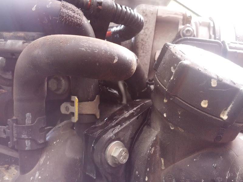

Engine went into limp mode and all the that fun stuff. Pulled off to the side and saw coolant shooting out of this thing;
What is this? I also noticed that there was what looked like dried coolant on some of the parts near it making me think this has been happening for a bit unknown to me. I plan to fill the resovior and drive it to the radiator shop not too far down the road. Help? lol
Looks like the thermostat housing... easy fix you can do yourself. Change the thermostat and O-ring too while your at it.

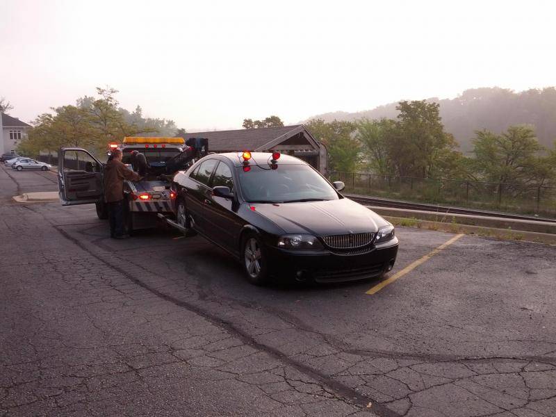

Meh I'd always insist on a flatbed as these cars have no steering lock.
Yeah, it was a little nerve racking but the guy came highly recommended so I let him do his thing. I followed him and he didnt even bottom it out once (which was sure was going to happen).
