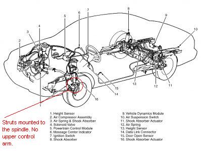

:slamPhfffft! Never mind. I just found a picture of the front suspension of a Conti and it did indeed use struts. So they won't work on a Mark VIII. Dangit!
The pic is kinda small, but you can plainly see the strut mounted to the spindle and no upper control arm. Which means that a bracket would have to be welded to the bottom of the shock (bad idea) so it would mount to the lower control arm and the bearing cap on top of the spring would have to be removed since the air spring/shocks on a Mark VIII don't turn with the steering like struts do. So it won't work. That sucks. Sorry for wasting space. I shoulda looked it up before I even asked. But it was a spur of the moment kind of thing.:)
