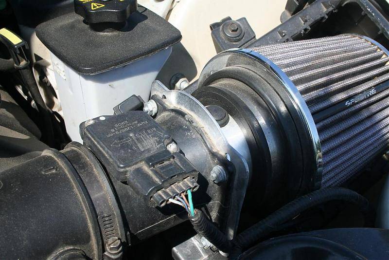

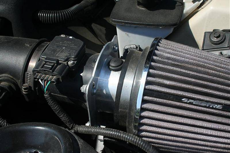

Tyler's right, it does take a little modifying to make it work. The MAF adapter plate needs to be drilled for the proper holes for the bolts to mate up to your LS's MAF. And then you need to visit the hardware store to get the bolts/washers/nuts to attach the adapter plate to the stock MAF. And I also added some foam tape between the adapter plate and MAF housing to get a good seal.

Oreilly's has a Spectre MAF adapter plate. It bolts on to the stock MAF housing, and the filter mounts directly to it.
Yeah, for a regular shaped MAF flange. Ours is all weird shaped... It's rectangular, and rounded on one side... I was there trying to find the best sollution and came up with mine, I was also only working with $30 too
Ah, I have the adapter plate. I just drilled new holes in it so it would mate up to the MAF housing. I'll see if I can get a pic...
Here you go:
