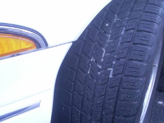

with the drop kit how many inches are between the tire and the fender? does it need to be dropped more(if possible) than the advertised 1 1/2? does anyone have pics?

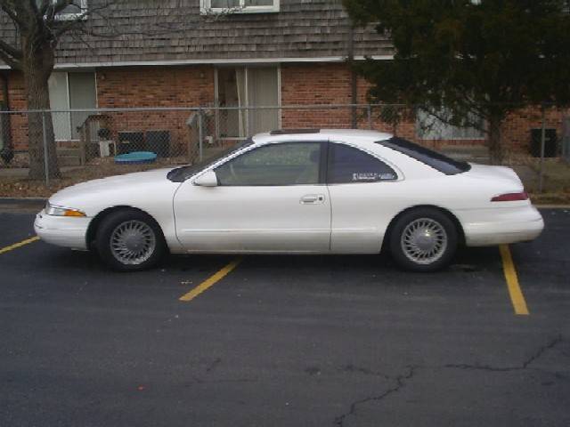

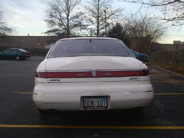

i have the kit from strutmasters,click my link at bottom,i have the lowered kit and love the stance, i also have wider lower tires,and a new solid sway bar, here are some pics, going over steep curbs is rough and be carful over speed bumps, but way cool, call strutmasters , ask for matt lofton and tell him jeff or sent ya from LVC.....worth it :Beer

BTW, my 94 is lowered, and I run 245/50-16's, with absolutely no rubbing, even at full lock.
