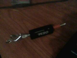

i bought this tool at pepboys, its $6.99
its used to test spark plugs but we can check coils too.
Its called ADJUSTABLE IGNITION SPARK TESTER.
you connect one end to the spark plug and another one to the coil. start your engine ant there should be a spark between the gap of the tool. if there isnt a spark then you have a coil or spark plug problem.
it wont give you certain readings or a value or anything is just a basic hand tool we all should have.

you are all correct, as i said this wont give you a complete reading or tell you when it fails or anything 100% reliable. but it will give you an idea. as i posted the other day i am having trouble with my coils.
Have you used this one yet? Might be a PITA to connect properly
yes i tested the ones that i could reach. found out that one coil wasn't working AT ALL.
right not im going to remove manifold and change the coils to the other side and test them too.
