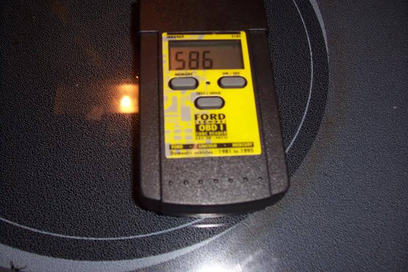

1995 Ice is pulling this code. A/C and cooling fan works fine. I googled heck out of it and can't find much. Any input?
586(M)Open circuit in A/C clutch - A/C and Fan Circuits

586 -- Variable Control Relay Module (VCRM)- open circuit failure in air conditioner Clutch circuit.
Ok since I'm on my own here I will just babble. I can clear all codes and get 111. Then if I start car then shut off the 586 comes back. I took the known good (no codes checked before pulled) VCRM out of my 1993. Still same code 586. I checked plug on AC pump took off and on still code 586. Then I took a good AC pump and put it on rad support and ran jumper wires to plug. I started car and turned AC on and clutch locked like it should. Still code 586 and 579 which means no pressure increase because it was just a pump sitting on rad support. So its not the VCRM,AC pump or AC pump plug. Also car has ZERO codes in the KOER test weird??? Passes with a 111. I need to find out what the plug at ac compressor should read any one know?
