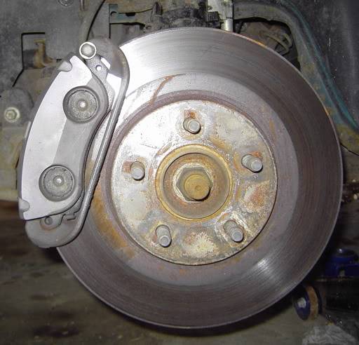

These were on my Taurus SHO with 11.6 rotors. Since the rotors share the same bolt pattern and approximate size this should work on Mark 8s with a bit of modification.
But I found them at carquest for 89.99 each, loaded with pads and mounts. The rotors were 38 bucks each, and I got the banjo bolts from mustang parts specialties for 32 bucks (they made me buy the lines from the cobra as well, dammmit)
All in all it was easy, hardest part was finding the right banjo bolt. I tried several from locals, but they were all about 1/4 short.
