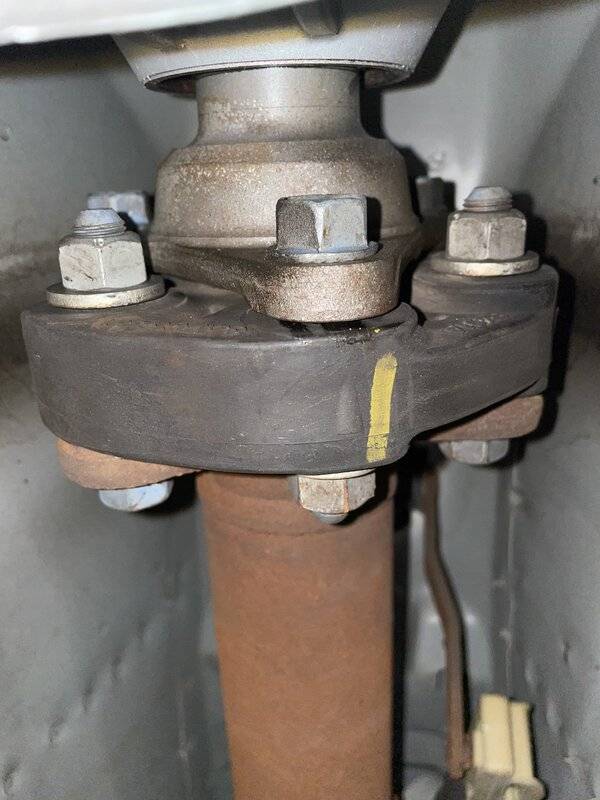

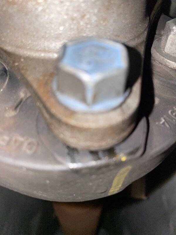

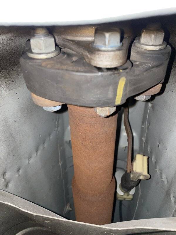

While looking around underneath today, I did notice what appears to be slight seepage from the driveshaft, close to where it mounts to the transmission. Could this be a cause for any concern, perhaps of another type?

The factory rebuilt trans would have all new intrnals installed... including a new solenoid pack. For the most part when a transmission is "rebuilt" ... the case is checked for wear, and new parts installed. Any case that ends up "out of spec" ... is rejected. I don't know for sure if Ford would "sleeve" certain areas like most "reputible" rebuild shops would... because that is "time intensive". Most likely a bad case would be discarded for "melt".
The driveshaft coupler in your pic does look questionable, and it would probably be best to replace that. However... it is part of a "balanced assembly" and should be taken to a driveshaft shop to be balanced... with the new coupler installed.
And since the driveshaft is a 2 piece design... it has a center support bearing, and over time the rubber surrounding the support bearing goes bad. If you are also getting a driveline vibration between 45mph and 60, (more noticeable in colder weather), the center support bearing needs replaced.

Maybe it's just the picture, but that bottom bolt on the flex coupler looks loose to me. That would explain your clunk. If it's not, then I still suspect that the clunk is due to something other than the transmission itself, like the center u-joint or the center bearing. Given the 22 year age of your car, I think that the center bearing carrier is actually a really good suspect.
(That is not a leak or seepage on the coupler. That's probably a stain from assembly.)
It does look like their is a gap in the photo. I’m not totally sure though if it’s flush on the other side. I’ll have to get it back up to take a look.
