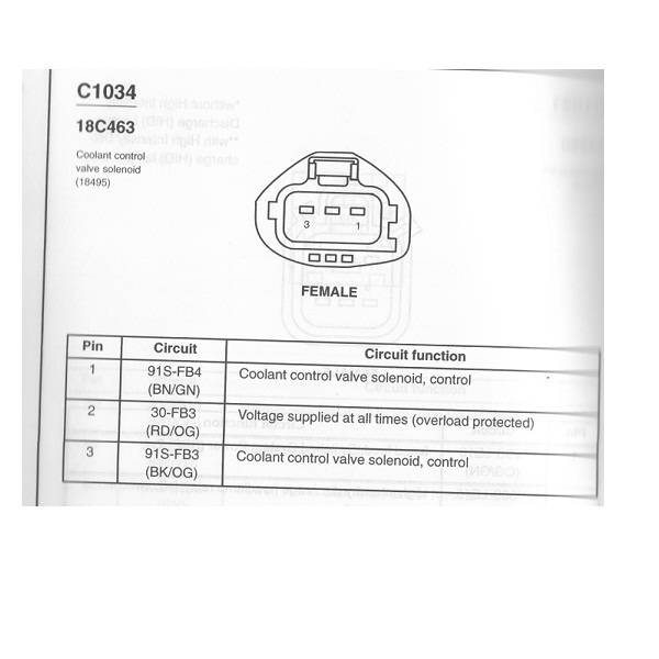

I replaced my Heater control valve, but the connector was burned up. I bought a new one but I don't know which wire to splice in as the new one does not have color coded wires. They are all black. The ones on my wiring harness are what appear to be Red, Black, black with blue stripe. Can anyone have a look at theirs and get a good photo or describe which colored wires go where?

The Brown/Green wire goes to pin 1.
The Red/Orange wire goes to pin 2.
The Black/Orange wire goes to pin 3.
This is at the connector at the valve itself, C1034.
Hey, Thanks a lot! I'm sure someone else will be able to use this info as well. Looks like I'll be soldering this evening :-)
