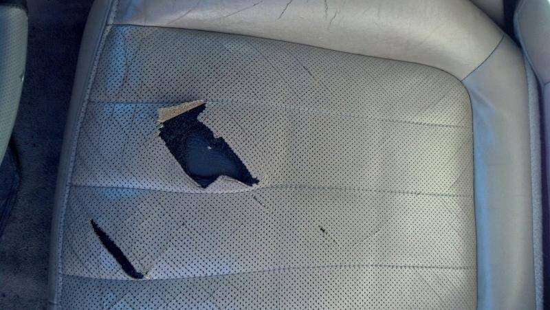

So my drivers seat has a hole in the leather now. The heated seat doesn't really work anymore, and it looks bad. Is there a way to redo the leather and put another heated seat module or something in it? or would it be better to buy a whole new seat and be done with it? I dont know much about this but any input helps.

A local auto upholsterer should be able to replace the damaged panel a well as install the new heating element (assuming gen 1 here....).
It's a heat and cool module that you need. It's not related the the torn seat at all (no heating element in gen II). There's a new one on e-bay right now for $180. They describe it as seat heater, lower air duct, but it looks like the whole thing.
I replaced the seat cover on mine. The cover was about $700 if I remember correctly.

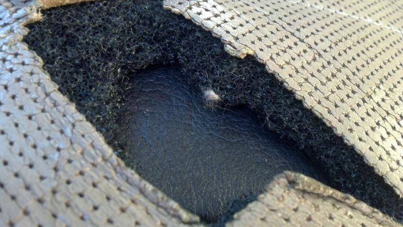

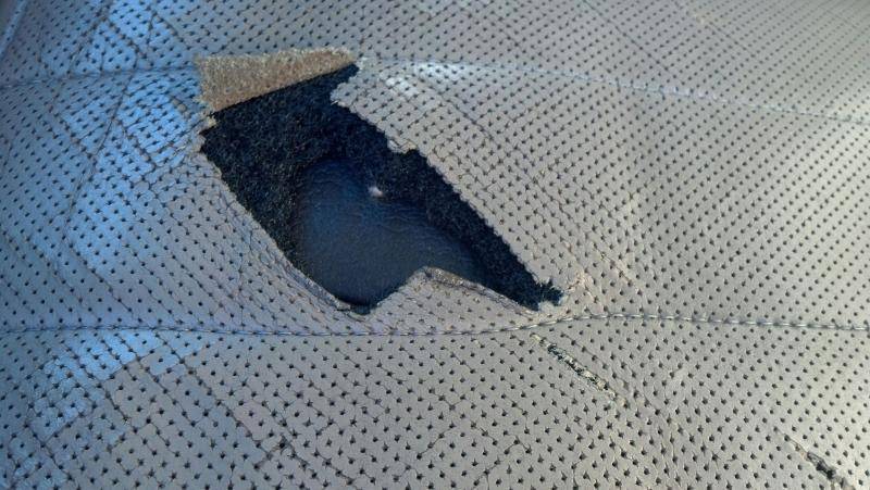

ResizedImage_1386789295937.jpgResizedImage_1386789318291.jpgResizedImage_1386789339731.jpg
700 to fix this? Is it a DIY kind of job? or do I have to take it somewhere?
Actually your right. sorry about that. I'm going to look into getting a replacement seat rather then re covering it. Try to save me a few hundred. Thanks for the help!
but with a seat cover around 500 bucks from fordpartsgiant? Might as well get a used replacement for cheaper.
Keep searching clist and ebay for a used seat in your color. And if you're really lucky you'll find one local that you can test before buying to ensure everything works.

I have replaced my seat cover myself. Bought the cover off of ebay. You will need to have a Hog Ring Pliers and a bunch of hog rings. A good hardware store will have these for you. Don't try to do this with a regular pliers, you need the right tool for the job. Took about 3 hours start to finish.
