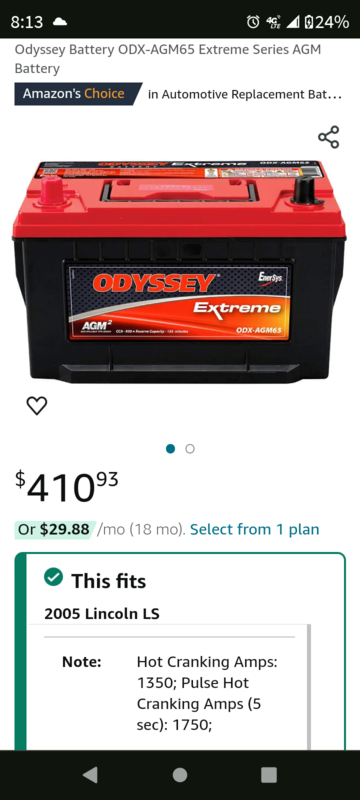

Had you rewire it for 12 volt setup and also got an AGM for my main,

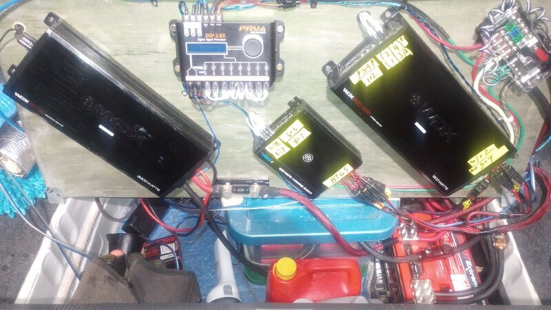

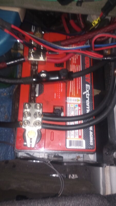

Screenshot_20240212-081328.pngIMG_20240210_151835485.jpgA little messy, and yes, working on the fire hazard. My lights dont dim anymore.
