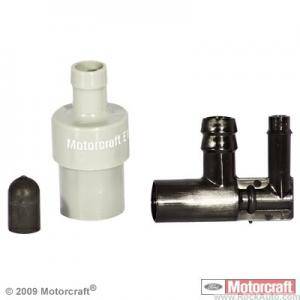

Since I had read about fitment issues with Fram, I decided to use the Motorcraft EV111 PCV Valve.
However, the light gray part of the new PCV valve attaches too easily and seems like it could come out under normal driving conditions. The old PCV valve was quite oily - is that normal ? Is it normal for a new part like this to not fit snug ?
When I looked at the old PCV valve, the "-xxxx" characters after EV111 were different from the new one I installed. Is that just a revision change to the correct part number ?
Also, when I moved a wire near the PCV valve, the new plug on the F connector fell down into the engine - where I can't see it. So I just used the plug from the old PCV valve. Is this a problem ?
Replace the rubber gasket that the PCV plugs in to. It's quick and only $3.
You want Dorman part number 42049, sold at Advance/AutoZone/O'Reilly as a Help!-branded product next to the PCV valves.
I know this gasket fits all 4-valve 4.6 cars and probably the 2v ones as well.

And the grommet is what will make the PCV valve fit snugly so it won't come out so easily ?
Is the "Standard Motor Products GV3 PCV Valve Grommet" the same thing ?

I contacted Dorman, but support said they didn't have a grommet for a Gen2.
For the benefit of others, the Ford part # is F6AZ-6A892-BA and costs about $8 from a Ford parts center.
