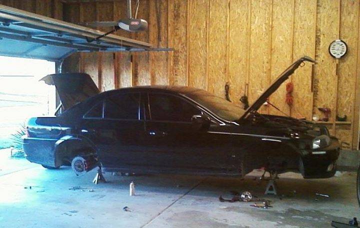

Alright as the title says, my car won't start. I put the car on jackstands and pulled the front suspension apart. Had the ball joints changed and my Eibachs installed finally. Put the car down and now the starter is rotating slower then it had. Never messed with anything electrical except pull the wires on the ABS on the hubs. I wouldn't think the starter would be bad since the car has been great before and no signs of a problem. Who knows though with this thing.
The last time I had it on jackstands in July to fix the exhaust the battery totally shot craps so I replaced that...and it's fully charged. Put it on jackstands again and now this. Totally ridiculous!! :mad: Makes me not want to jack the car up anymore. Any ideas?????
