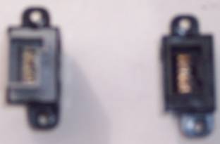

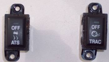

2. You may need to swap your traction control buttons between the consoles. If you look at the picture (one is blurry) you'll see that they actually use 2 different harnesses.

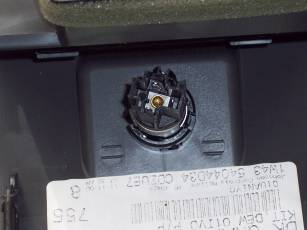

3. If you want to utilize the power point, we're going to need some more input. There was a guy on another forum that said he knew how to do this but he left the post in 2001 and his email doesn't work anymore. So somebody has done it before I know. I'm dying to get that part of swap working too, so if anybody has any suggestions - please input. I left some pictures of that too.
