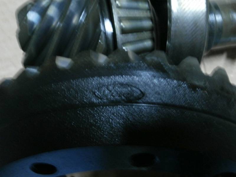

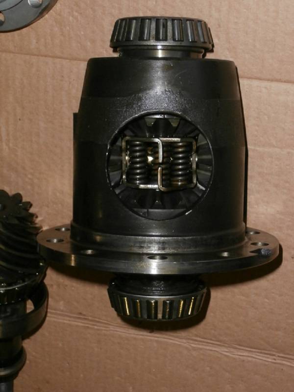

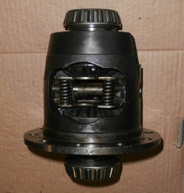

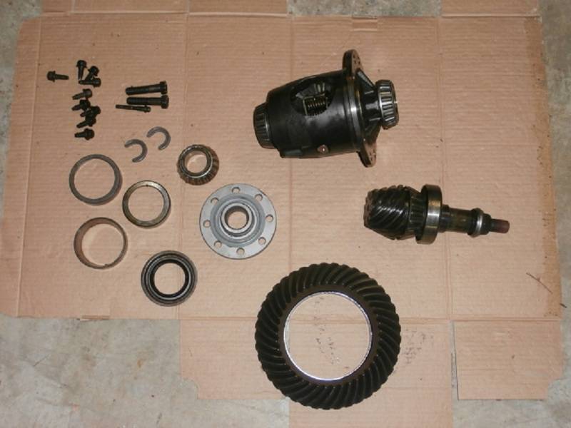

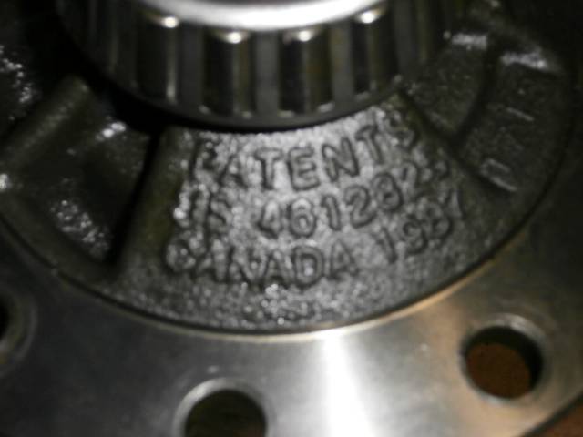

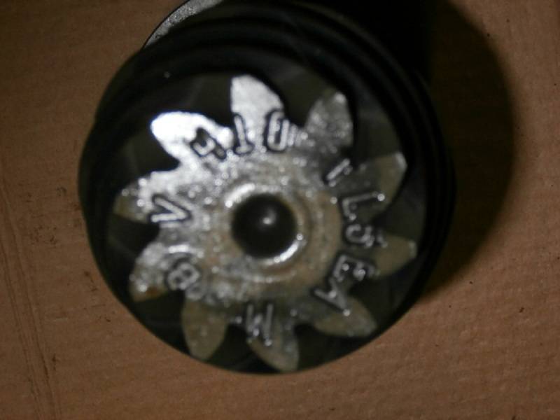

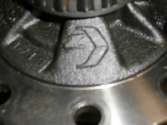

C/L find....stole it (virtually) used w/ 7k miles on it...looks brand spankin new
what type 8.8'' rear end is this? I counted 28 splines....the ring is 41 and the pinion is 10..
4.10 f#&ckers: you won, for now

beautiful Made in America, machined precision steel
Auburns are pretty good. Only thing is the reg one cannot be rebuilt only the auburn Pro can be from my old nogin. How much for all that?
$75, I could have given less, but the seller was a young Navy vet, VOFW
....counting the splines in the carrier makes my eyes hurt...pretty sure it's 28
Yup, thats the base model auburn, with the cone type clutch. Do not use this to drag race. This differential does not hold up to drag launches. It can't be rebuilt.
Aurburn does state in ad for this "not recommended for drag racing" I think they mean high rpm clutch drops on slicks.But we really don't know. Our cars at strip are like street launches. All I know is my Ford trac lock handles 1.58 60ft in mine.
Yup base Auburn. I think the drag deal is the cones dig into the case and hard launches shorten the life/added wear/eventually won't grab.
Good deal tho for a Mark swap. 28 spline is perfect unless you have swapped to 03-04 Cobra axles.

before I found this set locally (the 4.10:1 and the Auburn) I purchased on ebay a used Trac-Lock ($85) from a GT that will be here in a few days; if they were both in like new cond, I'd use the Trac Lock and sell the Auburn, but I'm thinking the Trac Lock has more miles on it and may need rebuilding, so I plan to use the Auburn...unless the Auburn is destined to fail...no drag racing for me; not sure what 'launch' implies
Auburn will be just fine then. Launch refers to punching the throttle/dumping the clutch at the start of a dragrace.
Yeah launch as in accellerating hard from a dead stop, I don't see how it couldn't handle a fairly stock mark viii with roughly 250 ft lbs of torque at the wheels, its one thing if it were a manual dropping the clutch at a high rpm, but with an auto it really doesn't shock the driveline very much since there's already a load on the trans, driveshaft and IRS, especially if you're brake torquing it.

Just as long as you don't neutral bomb your mark, that auburn should hold up. Shame its not a 31 spline.

re: 31 spline..why a shame?
re:4.10's....you're using 3.73's? or is that just in the smaller ?Mousestang?
If it was 31spl then it would give a good excuse to upgrade ;)
