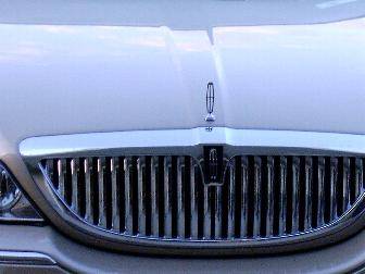

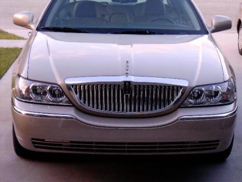

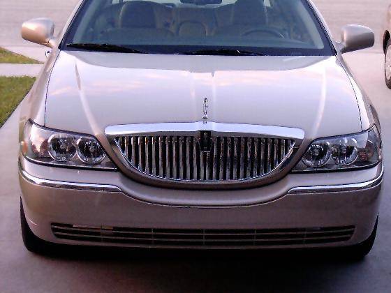

So i got a good two months out of my car between repair visits. Even though its not costing me anything i am feeling some of you with your worries about the expense associated with an LS. This time while driving with the cruise set at 70 mph a warning chime went off and stated "Check advancetrac", both the abs and advancetrac lights came on and stayed on. From my research it looks like a wheel sensor is usually the problem. This time though i took it to an actual Lincoln Dealer. I must say the experience is much different than a Ford dealer. Didnt have to haggle about a rental they just gave me a new Town Car Signature. The Town Car is nice but its HUGE. Its definately the old man version of the LS. The V8 is kinda mushy but its nice to have RWD. A Town Car is missing some nice touches that the LS has, but also has its nice things. Its funny because this car has both the hood ornament and the grill emblem, which i know has been discussed here and i think it looks a little silly.

That does look weird, I never noticed that before. Almost looks good, like a shadow or reflection of the hood ornament star.... buuuut not quite :bash:
