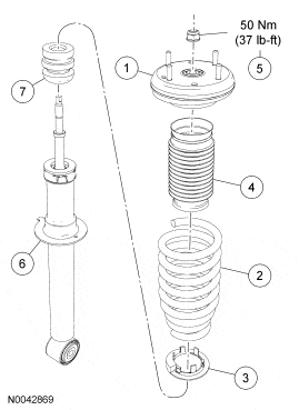

You don't have to take them out but you would need to rent/buy a spring compressor. You can check this pretty easily. There is a groove in the seat where the spring sits, and the end of the spring coil should be bumped right up to the edge of that groove.
Its easier to understand when you look at the pic. Look at the bottom of the spring.
IIRC there is something similar at the top as well. If the shop installed them incorrectly you should take it back and have them correct it. But be sure to check both sides first.
The left and right front springs are both touching that plastic piece on the bottom. The right side plastic piece is not exactly at the same spot as the left I dont think this matters just sayin
We may be missing the obvious. Z'sLS, Do you weigh over 600 lbs by any chance? If so, I think I know your problem.
Shocks don't support the car, so no. As mentioned, spring clocking is important. Correct clocking means the "tail" of the spring is in the correct (and same) position on both sides. From your statement above, it sounds like this may not be the case?
